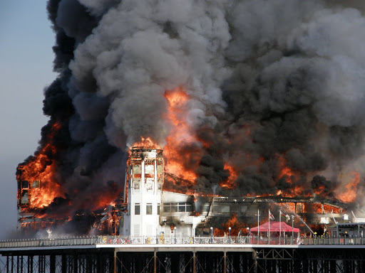

Have a look at this picture showing a seaside pier funfair decorated with neon lighting. Another picture from the outside shows the spectacular display of light created by loads of neon tubes all around the sides.
But unfortunately when lots of high voltage lighting is installed on an old wooden building it can cause illumination of a different kind - see here   :o
(That is the same place as the previous two pictures)

Re: Neon lighting - good and bad! « Reply #5 on: September 02, 2012, 12:02:56 PM » Author: Ash
The problem is not with maintenance, but with the fact that whoever installs those high voltage tubes does not give them the caution they deserve
Neon tubes work at 1000-3000V or so. Those are voltages at which many odd things happen :
 - Arcs up to few mm long can happen in open air, and be very stable. Unlike 240V arcs which are rarely over 2mm long, and nowhere as stable. There is a reason why its called high voltage
 - The transformer is a limited current source to about 30mA. When you have a short circuit in 240V, there isno much limit on the current - there will be a several KA bang, and tripped breaker. When its 1KV at 30mA it is a stable burning arc dissipating 30W. Its about the same as a constant flame burning in there instead of the arc, would be about the same amount of heat. Burning for as long as it takes to set something on fire, no breaker tripping whatsever
 - Electrolysis and arc tracking effects go on nicely at such voltages. If 240V takes ages to electrolyse wood, 1KV+ is arcing through wood as if it would be metal
 - Voltage is high enough for electrostatic effects to take place (though to a lower extent because its AC) : fine dust accumulating in the way for a flashover etc, making over time places where a flashover is going to be imminent
And the story of a fire comes down to this :
Designer wanted to make a sign easily, so he used a wood backboard and painted it and installed the tubes
The tubes worked for many years, somewhere a silicon cap (on the connection of wire to the tube) snapped due to old age and exposed the wire
Some dust accumulted there making a conductive path to the wood back board
The dust flashed over and the arc kept going on,, maybe even unnoticed - electrolysing the wood and burning it up to carbon, The arc keeps going on and dissipating the heat in the crbon
Carbon ignites
Fire
So basically :
Pick the corect materials for the job and dont use materials which are flammable or prone to arc tracking. Wood is no-no. Plastic is not too good either but at least it is not outright conductor for such voltages
Avoid "depending" on materials that are going to degrade over time. Installing the sign outside in sunlight ? Use a shrink wrap over the wires for extra UV protectn, use longer stand offs for the tube
Dont let the sign accumulate dirt, and maintain it
